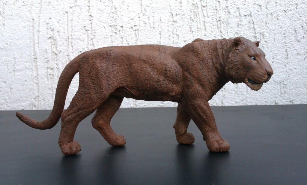

7. I`m starting to play with the texture.
Now, this is something, which I think is  interesting in my way of repainting...and I like when I see, that some major brands is using it for some models.
I`m mixing a slightly lighter color from the same paints... together with some water.
I`m taking the same big brush, but this time I need the brush with the paint to be more dry.
How I`m doing this ?
I`m taking a little bit of paint with the brush and then, before painting the model, I`m scrubbing on
palette, until the brush is more dry, but still has paint on it.
Now, I`m starting with this technique :
Very fast , but gentle moves with the brush, over the surface of the model.
Like this, we can see, how the texture become more visible :
Repainting a TIGER in ``Kosta`s style`` :D Image
8. Ok, next step I called : ``Too much texture `` :)
What I mean is, that if I let the texture, to be visible like this everywhere..then will be boring , becouse is too much. That`s why I`ll cover some places with the same color...
...just with more wet brush.
And these places are the muscles, which are more visible. Then , I`ll have more dark texture in more concave areas :
As you can see, my process of repainting is going from dark to light colors.
The tiger it`s still very dark..but with next steps and colors will be diferent.
Tomorrow, more Wink
